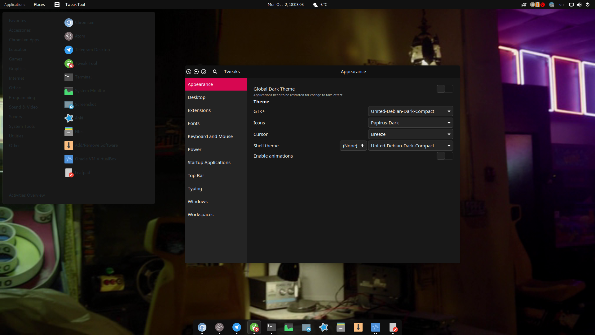

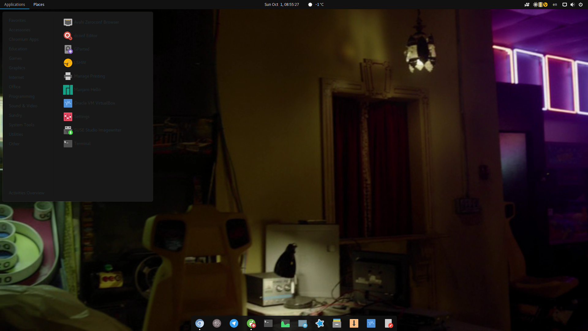

The top panel after the last manjaro update began to look like this (with many shell themes) #10
Closed
opened 2017-10-01 16:02:53 +00:00 by philm · 15 comments
philm commented 2017-10-01 16:02:53 +00:00 (Migrated from gitlab2.manjaro.org)
Created by: darleneeon
issue
issue2
*Created by: darleneeon* ![issue](https://user-images.githubusercontent.com/29887971/31056432-93f4a406-a6fb-11e7-9e9d-fc1e3ef17398.png) ![issue2](https://user-images.githubusercontent.com/29887971/31056430-938d1426-a6fb-11e7-8b70-4fe39bbd5783.png)
philm commented 2017-10-02 05:39:09 +00:00 (Migrated from gitlab2.manjaro.org)
Created by: Ste74
Remove manjaro-gnome-maia-theme if installed .. what is your theme ?
*Created by: Ste74* Remove `manjaro-gnome-maia-theme` if installed .. what is your theme ?
philm commented 2017-10-02 09:26:24 +00:00 (Migrated from gitlab2.manjaro.org)
@Ste74 nothing changed. My theme is United, but issue affects all themes (even Arc), except Adapta.
*Created by: darleneeon* @Ste74 nothing changed. My theme is [United](https://github.com/godlyranchdressing/United-GNOME), but issue affects all themes (even Arc), except [Adapta](https://github.com/adapta-project/adapta-gtk-theme).
philm commented 2017-10-02 09:52:38 +00:00 (Migrated from gitlab2.manjaro.org)
Created by: Chrysostomus
I have the issue too. After installing the gdm theme, all shell themes have some wrong colors. Removing doesn't fix it.
*Created by: Chrysostomus* I have the issue too. After installing the gdm theme, all shell themes have some wrong colors. Removing doesn't fix it.
philm commented 2017-10-02 10:27:16 +00:00 (Migrated from gitlab2.manjaro.org)
@Chrysostomus yes, gdm theme was updated
*Created by: darleneeon* @Chrysostomus yes, gdm theme was updated
philm commented 2017-10-02 10:41:43 +00:00 (Migrated from gitlab2.manjaro.org)
Created by: Ste74
@darleneeon sorry not understand if after remove manjaro-gnome-maia-theme and rebooted all is fine :(
@Chrysostomus , problem is this : i have forced the install the gdm theme ( now i have correct this and is optional ) but this theme depend on adapta .. So i think is this the reason ..
*Created by: Ste74* @darleneeon sorry not understand if after remove manjaro-gnome-maia-theme and rebooted all is fine :( @Chrysostomus , problem is this : i have forced the install the gdm theme ( now i have correct this and is optional ) but this theme depend on adapta .. So i think is this the reason ..
philm commented 2017-10-02 10:58:48 +00:00 (Migrated from gitlab2.manjaro.org)
@Ste74 so how to fix it now?
*Created by: darleneeon* @Ste74 so how to fix it now?
philm commented 2017-10-02 11:02:12 +00:00 (Migrated from gitlab2.manjaro.org)
Created by: philmmanjaro
Is it a dark settings issue? Checked with gnome tweak tool yet to set it to light mode?
*Created by: philmmanjaro* Is it a dark settings issue? Checked with gnome tweak tool yet to set it to light mode? <img src="http://surfontech.com/osreviews/gnometweaktoolFedora22.png">
philm commented 2017-10-02 11:06:39 +00:00 (Migrated from gitlab2.manjaro.org)
@philmmanjaro no it's not
*Created by: darleneeon* @philmmanjaro no it's not ![image](https://user-images.githubusercontent.com/29887971/31074680-07a5a0da-a79c-11e7-8e63-e98b185bca95.png)
philm commented 2017-10-02 11:15:16 +00:00 (Migrated from gitlab2.manjaro.org)
Maybe activate it, as this option is changing the font for dark themes. Seems the used theme is dark and the option should be on by default. Enable it and re-login.
*Created by: philmmanjaro* Maybe activate it, as this option is changing the font for dark themes. Seems the used theme is dark and the option should be on by default. Enable it and re-login.
philm commented 2017-10-02 11:34:59 +00:00 (Migrated from gitlab2.manjaro.org)
@philmmanjaro no, it doesn't solve the issue
*Created by: darleneeon* @philmmanjaro no, it doesn't solve the issue
philm commented 2017-10-02 11:36:01 +00:00 (Migrated from gitlab2.manjaro.org)
@Ste74 @Chrysostomus @philmmanjaro the only way I see is to reinstall the whole system
*Created by: darleneeon* @Ste74 @Chrysostomus @philmmanjaro the only way I see is to reinstall the whole system
